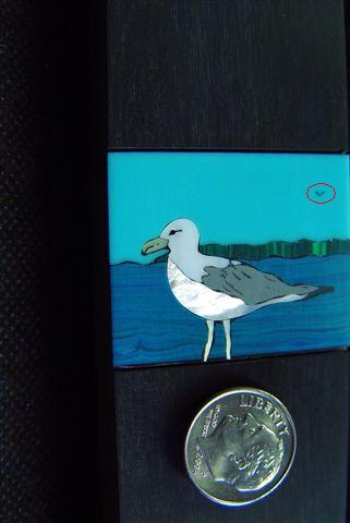

Here's an inlay just completed on a custom mountain dulcimer.
My customer requested various beach scenes for his daughter on this instrument, which will be a surprise birthday gift!

What size blades did you use for that? I have been fond of 06 lately.
One other thing- What is the material for the grey back wing area? I'll tell you my secrets if you tell me yours!

Very Nice! What did you use? Corian & pearle? How about for the pilings?

Thank you all for your 10 cents,(or is it 2 cents?)
The secret grey material is ... a section cut out of a receptacle box for industrial wiring. It was the closest I could find in color!
The inlay was cut with 3/0 and 6/0 blades, using MOP,Black lip at the tail, white river pearl,and various recon stone.
By the way, the dime was the easiest part of the job.

You know of all the colors available from pre-made materials there is no real grey.
I need to get me an electrical box now! I am always needing grey! Any particular type used?
Thanks.

Nothing particular, Craig. Just an inexpensive nail on style box.
I struggled for weeks on an inlay several years ago duplicating a Lladra- Happy Anniversary statue.
The pants were grey and the only thing I found close in color was that box.
Fortunately, most colors are available, though my wife will occasionally cringe when I run from basement to bandsaw!

The part that I find so amazing (other than the entire thing) is the little bird flying off in the distance
So cool, it's smaller than the lettering on the dime.
Rod True38814.7862731482
PostPosted: Fri Apr 07, 2006 2:01 pm
The flying bird has to be a little paint, right?

Carlton, It's actually just a small engraving in the most basic form. After the lines are engraved, a bit of filler is rubbed in the shallow cuts to highlight it.

Paul, you old trickster!!! I (obviously) hadn't thought of that. Thanks for the info.
